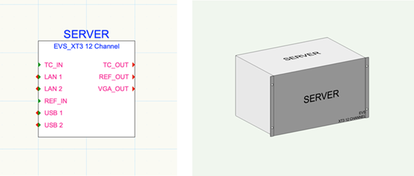

Devices have a schematic appearance, intended for use on schematic drawings, and a layout appearance of the equipment, for 3D modeling and layout views of the drawing.
On the left, the schematic device provides a simple diagrammatic view of the connectivity.
On the right, the equipment item represents the physical model.
The device and the equipment item are associated. The data that defines them (make, model, physical data, location data, and more) is contained in the device definition record, which is part of the equipment item's 3D symbol definition. The information in the record is used to create instances of any given make/model as devices on schematics or layouts. The device definition data can be edited by advanced users; see Editing the device definition data.
