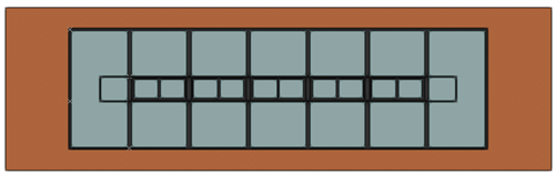

The door's width is fixed, so the windows widen when the assembly is resized, but the door doesn't
