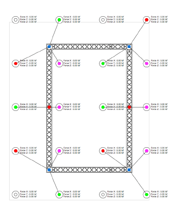

Vectorworks Spotlight offers a suite of commands and tools for designing and analyzing bridles and their connected support structures. With a Braceworks license, you can perform load calculations to assess the structural stability of the rigging system. When the design is complete, bridle assembly diagrams and parts lists can be easily generated for the riggers on-site.
When a truss lacks adequate rigging points directly overhead, a bridle can be used to support the truss. Add bridles to a venue file that already contains the event rigging.
