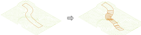

This command is also effective for stakes, 3D loci, 3D polygons, 3D primitives, extrudes, sweeps, meshes, slabs, light objects, walls, and symbols with a 3D component. If a 2D polyline or 2D polygon is selected, it will first be converted into its 3D equivalent before being sent to the surface.
This command also works for Extrude Along Path objects; you can fit the 3D portion of the path object to the surface.
