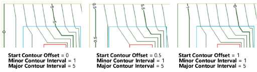

Minor Contour Interval
Specifies the standard contour line placement interval
Major Contour Multiplier
Specifies the placement interval of major (heavy) contour lines
Start Contour Offset
Controls the starting elevation of the 2D contours

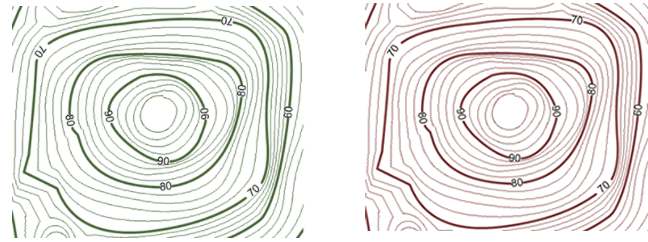

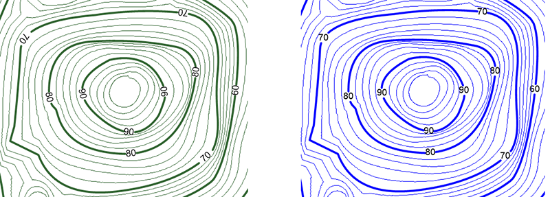

Parallel to the topo line
Displays contour labels parallel to the topography lines
On the left, Parallel to the topo line is selected. On the right, it is deselected.
Adjust label direction
When deselected, labels are aligned to the highest point, which is typical for contour labels. Select this option to control the label placement with the Adjust flipped text parameter on the Display tab of the document preferences.
On the left, Adjust label direction is deselected. On the right, it is selected.
