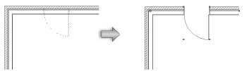

To insert a door in Vectorworks Design Series:
  1. Select the Door tool from the Building Shell tool set.
  2. Alternatively, if placing a curtain wall door into a curtain wall, select a panel with the Edit Curtain Wall tool, and then right-click (Windows) or Ctrl-click (Mac) on the panel and select Insert Door from the context menu. The door is automatically inserted as a curtain wall door.
  3. Do one of the following:
  4.     To use an existing door resource, click Active Def on the Tool bar. From the Resource Selector, locate the desired resource, and double-click to activate it.
        To create a custom door, click Preferences from the Tool bar. The Door Settings dialog box opens. The settings are grouped into several panes of related parameters, which are listed on the left side of the dialog box. Select each pane and specify the door parameters. Click OK to set the door parameters and close the dialog box. These parameters can be edited for placed doors from the Object Info palette, as described in Door Properties.
  5. Click in the drawing area or in a wall to set the insertion point of the door, and click again to set the rotation. The direction of a door inserted in a wall can be changed later by clicking Flip from the Object Info palette or from the context menu.
Several features of the door are described as “interior” or “exterior.” These include trim and wall-wrap parts. These elements are determined based on the internal and external faces of the wall. The left side of the wall (as viewed along the wall direction) is always “exterior,” and the right side is “interior” (see Wall Direction). Flipping the door does not flip these elements.
