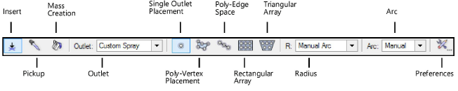

The following modes are available:
Mode
Description
Insert
Inserts an outlet according to the selected placement mode
Pickup
Sets the default outlet settings to match those of a selected existing outlet; see Transferring Outlet Attributes
Mass Creation
Places outlets on or within a valid object (pipe or polyline); see Transferring Outlet Attributes
Outlet
Opens the Resource Selector to select an outlet resource for placement; double-click a resource to activate it.
Select from one of the manufacturer libraries, or select an outlet closest to the type you need from Custom.vwx and set its properties after placement.
Single Outlet Placement
Places a single outlet as configured
Poly-Vertex Placement
Places a configured outlet at each clicked polyline vertex
Poly-Edge Placement
Places outlets along the drawn polyline with the Tool Linear/Array Settings specified in the tool preferences
Rectangular Array
Fills the drawn polyline with outlets in a rectangular array with the Tool Linear/Array Settings specified in the tool preferences
Triangular Array
Fills the drawn polyline with outlets in a triangular array with the Tool Linear/Array Settings specified in the tool preferences
R
(radius)
Defines the default throw radius of the spray for rotors and spray outlets, or the spacing between emitters. If the outlet came from a manufacturer’s catalog, select one of the available throw Radius values, or select Manual or Manual Arc to specify the radius at placement. For certain outlets, select Manual Strip to place a strip outlet.
For outlets only, browse through the radius values in the Tool bar list by pressing the shortcut key, and browse backwards through the list by pressing Shift + the shortcut key.
For a custom outlet, the throw radius is determined at placement; select Manual Arc to place a circular outlet with the arc manually specified, or Manual Strip to place a strip outlet.
Arc
Defines the spray pattern coverage in radial degrees; does not apply to emitters. If the outlet came from a manufacturer’s catalog, select one of the available Arc spray pattern values, or select Manual to specify the spray pattern arc at placement.
For a custom outlet, the spray pattern arc is determined at placement; if Manual Arc was selected for the Radius, Manual is preselected here and no other selection is necessary. For Manual Strip outlets, select the location of the outlet along the strip.
Preferences
Sets the default preferences for the outlet placement and appearance

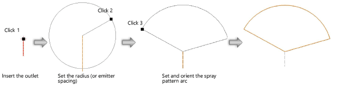

  6. Click once to set the outlet location. If placing the outlet over an existing pipe, drip tubing, or irrigation pipe network, the connecting pipe is highlighted and the outlet is automatically connected to the network.
  7.         For arc outlets, move the cursor and click to set the throw radius. If the outlet was selected from a catalog, the cursor snaps automatically to the predefined radius values specified by the catalog; refer to the Data bar for the radius values. If a custom outlet is being placed or a custom radius defined, move the cursor to specify the radius at placement and click. For emitters, the drawn radius indicates the emitter spacing.
            For strip outlets, click to set the start of the strip, and then move the cursor to set the width and height of the rectangular strip.
  8. Click again to set the outlet spray pattern arc (if not set by the catalog value) and orientation, or for strip outlets, to finish drawing the strip.
  9. A single outlet has been placed and oriented.
  10. For multiple outlet placement, continue by drawing a line or a polyline, depending on the placement method selected. A dynamic preview of the outlets displays to help with placement. Double-click to place the outlets.

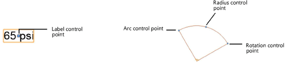

Adjust the position of any pressure and flow labels by dragging the control point. Adjust the radius, arc, and rotation of spray outlets with the coverage control points, when the spray coverage is visible. Catalog data requirements may constrain the allowable adjustments.
