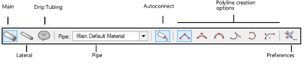

The following modes are available:
Mode
Description
Main
Creates a main line pipe
Lateral
Creates a lateral line pipe
Drip Tubing
Creates drip tubing
Pipe
Opens the Resource Selector to select a pipe resource for placement; double-click a resource to select it.
Select from one of the pipe libraries, or select the drip default material or main default material for the pipe and set its properties after placement.
Autoconnect
With this mode enabled, when the pipe is drawn over existing, valid irrigation objects such as valves, outlets, and POCs, they are automatically connected to the pipe. Connecting the drawn pipe to an existing pipe splits the existing pipe.
When this mode is disabled, the drawn pipe is not connected to objects unless the pipe’s endpoint touches the objects.
Polyline Creation Options
Selects the method for drawing the polyline upon which the object is based; see Creating Polylines
Preferences
Sets the default preferences for the pipe object

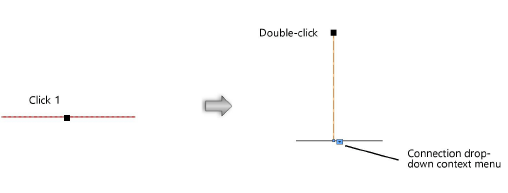

  5. Click to place the start of the pipe, and draw the pipe polyline, clicking at each vertex. Double-click to finish drawing the pipe.
If Autoconnect mode is on, the pipe connects any valid irrigation objects that it crosses. When one end of the pipe is placed on another pipe, they are connected, and the existing pipe is split into two pipes.

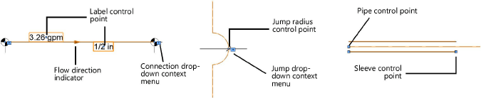

A pipe drawn over another pipe displays with a jump at the intersection of the two pipes. Adjust the jump radius with the control point; hide or show the jump with the Hide Jump or Show Jump drop-down context menu command.
The pipe properties can be edited from the Object Info palette.
