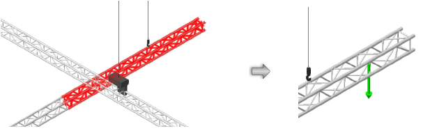

Move the mouse to the rigging object where the point load is to be hung, near the center line.
Valid rigging objects are highlighted.
Click to place the point load at that location. The point load is placed at the centerline of the rigging object.
