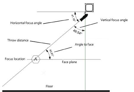

Throw Distance |
Controls the distance from the lighting device to its focus location. If a focus point is assigned, this value automatically updates. |
Vertical Focus Angle |
Displays the focus angle up from vertical
Horizontal Focus Angle |
Displays the focus angle down from horizontal |
Angle To Face |
Displays the angle at which the light hits the face plane of the lit subject at the focus |

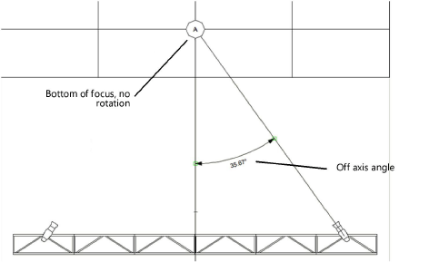

Off Axis Angle |
Displays the angle from the centerline of the focus to the lighting device. The bottom of the focus is the centerline; if a focus point is used, move the focus point to change the centerline location.
