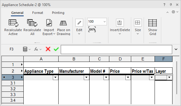

In the following example, spreadsheet row 1 contains labels for each column in the database. Database header row 2 has its criteria set to list all the objects in the drawing that have the appliance record attached to them. These objects display in sub-rows 2.1 through 2.5. For row 2, columns A through D list the contents of the data fields in the appliance record: the appliance type, manufacturer, model number, and price. Column E contains a formula, which uses the value in column D to calculate the price of the appliance with sales tax. Column F lists which layer of the drawing contains the object.

Database rows display data fields, calculations, or images associated with the objects in a drawing. When you create the database row, set the criteria to determine which objects will be listed in the related sub-rows. For example, you might set a header row to list all chairs in the drawing. (If no object meets the header row criteria, no sub-rows are created.) You can specify multiple criteria; for example, create a list of all the chairs in a resort, or list only the green wing-backed chairs from all the two-room suites that are scattered throughout the resort.
In each cell in the database header row, specify which information about the objects to display in that column. A column can list a specific property of each sub-row object, such as its class or layer. A column can also list a data field contained in a record attached to each object. Alternatively, a column can contain a constant, an image, or a formula, just as a spreadsheet cell can.
