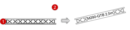

In Single Insertion mode, move the mouse to orient the truss, and click again to place it. For a hinge truss, click a third time to set the truss angle.

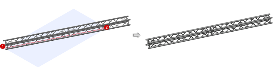

In Distributed Insertion mode, click to place the first truss. Move the mouse to orient and place the trusses along a line; trusses are placed end-to-end, and the preview indicates how many trusses will be placed. Click again to place trusses along the full length of the line. If the line length is not an exact multiple of the selected truss length, an additional truss is added to complete the line, resulting in a longer truss line.

Adding a truss in Distributed Insertion mode in a 3D view

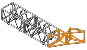

Move the mouse to hover over an existing truss; valid connections are highlighted.
Depending on the type of truss to connect and the view, various insertion options are previewed. For example, connecting a three-way corner truss shows different options from connecting a four-way truss, and connecting a book hinge shows different options from connecting a center hinge. For all trusses, Top/Plan view provides different options from 3D insertion.

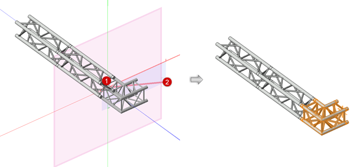

If you are placing a corner or hinge truss, click once to place the truss element at the highlighted location (where truss magnet snapping occurs). In a 3D view, the working plane appears, with a red guide line; move the mouse to view the possible orientations for the truss element, and click when you have the correct orientation. For a hinge, click one more time to specify the hinge angle. In Top/Plan view, you cannot see the working plane or the guide line.
If you are having trouble connecting to the system with the desired orientation, especially in Top/Plan view, click Change Insertion Point mode (which acts as a button, rather than a mode). This changes the insertion point of the inserted truss to the next magnet. In Top/Plan view, clicking the button switches between 2D magnets, and in a 3D view, it switches among 2D and 3D magnets.
When connecting to an existing truss, click to connect, move the mouse to orient (or click Change Insertion Point mode), and click to place
