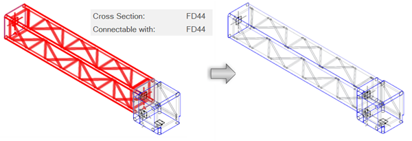

Only compatible trusses can connect. If the truss to connect does not cause an existing truss to highlight, it is because they are not compatible, or one of the rigging objects does not have a valid Connectable with parameter.
The existing truss is of the Type FD44 and can connect to otherFD44  trusses. When adding another truss, such as this corner element, the Type must also be FD44 for the system to be created.

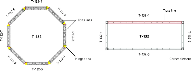

A completed truss system consists of truss lines connected with hinges or corner elements, as shown in these simple illustrations. Example naming of truss lines and the system are shown; see Renaming truss systems for more information.
