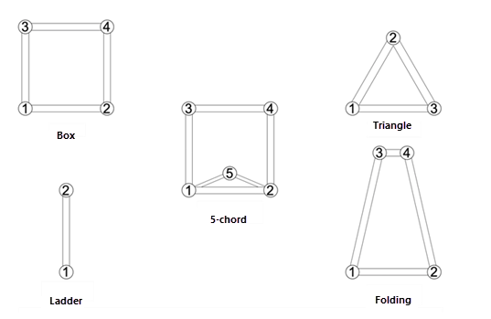

Attach a Truss Chord Info record to each snapping polygon. Each record has a Chord Width record field (in document units) and a Chord ID record field. The Chord ID value must be unique for each truss; the diagram below shows how various truss types have been numbered according to Vectorworks' standards.
Truss symbols with chord numbering in 3D Right view
