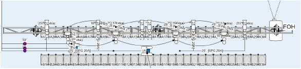

There are multiple ways to power patch electrical devices in the drawing. Cables can be drawn manually with the Cable tool, supporting 2D and 3D workflows. Cables can also be inserted automatically when patching by command or patching from the Object Info palette. You can also create an editable schematic of the electrical system that displays the signal flow and power consumption data, and is associated with the light plot (see Concept: Power schematics).
Once a cable run is placed in the drawing, you can reshape it or exchange the parts as needed. Create a report listing the cable parts required in different areas of the drawing. Cable objects are compatible with Braceworks, so the cable impacts on a system can be calculated seamlessly (Braceworks required).

Define the event's power distribution layout. Place the appropriate distributors (breakouts and/or plugboxes) on the trusses, located near the electrical devices that require power. The power consumption of all electrical devices connected in a daisy chain configuration is summed at the distributor.
Draw commonly-used cable routes with the Cable Path tool.
Power patch the system by connecting the electrical devices (or by connecting the electrical components, if you create custom devices). If enabled, power patch devices connect to the first free output with the same connector as the destination if possible; otherwise they are connected to the first free output.
