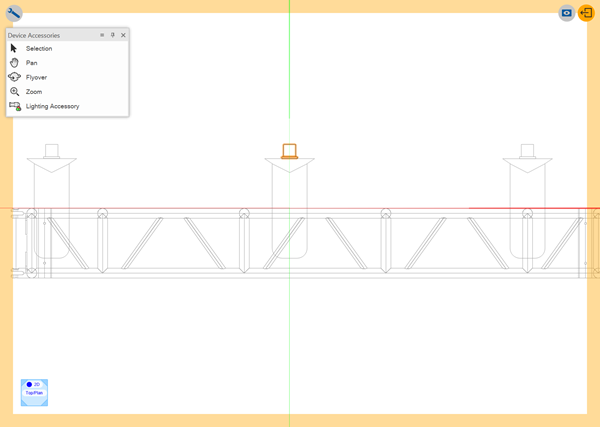

In accessory edit mode, the view and visibility settings change temporarily to assist with editing. The available tools display in a special Device Accessories palette. This includes the Lighting Accessory tool, which behaves differently from the same tool in the drawing area. The floating Device Accessories palette is only available within the editing mode, and can be positioned anywhere on the screen or docked in any of the potential docking positions; see Palette features. Click the tool icon  to hide the palette, and click again  to display the palette. Double-click the tool icon to reset the palette's position to below the tool icon and display the palette (regardless of whether it was hidden).
In accessory edit mode, the tool has different modes and provides arrow buttons for scrolling through a selection of lighting devices. Use the arrows to locate the device you want to edit. The drawing origin and the working plane center match the insertion point of the displayed lighting device.

On the Object Info palette, click Edit Accessories and Hardware to open accessory edit mode. The view zooms to the lighting device (or the first selected lighting device in a multiple selection), shown in default orientation. Whether other model objects display or not depends on the edit mode settings on the Vectorworks preferences: Display pane.
All default menu commands and tool palettes are disabled except for the special Device Accessories palette. Use the available tools to insert accessories and change the view as needed.
