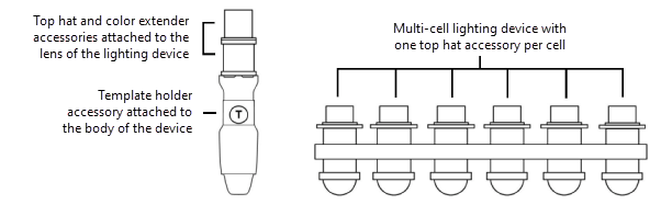

A lighting device, whether a single-cell or multi-cell, can have accessories in different locations. It can also have multiple accessories in the same location, typically the lens.

Once an accessory is added, it becomes part of the lighting device geometry. As you move and focus the device, its accessories move and rotate with it.

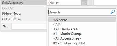

Each accessory has an index number that displays in the Object Info palette, the Lighting Device dialog box, and the Patch dialog box. In the Object Info palette, base accessories are categorized as either Hardware (such as clamps) or Accessory. The index number is determined by the stacking order: hardware/accessory #1 is the first created hardware/accessory in the default stacking order, or the hardware/accessory that is the farthest “back” in a custom stacking order.
Accessories and hardware are identified by index number and symbol name and categorized as Hardware and Accessories

The lighting device Object Info palette displays the parameters shared by the lighting device and its accessories/hardware. Select the accessory or hardware to edit (or select all accessories and/or hardware for editing) from the Edit Accessory list, and set the parameters as described in Editing from the Object Info palette.
