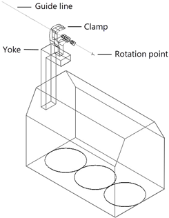

Place a 3D locus within the body at the rotation point for the cell.
The cell rotates about the yoke. If the cell you're creating is not yoked, use a guide line to identify where the rotation point is located on a yoked cell; note the height of this point within the cell. Then, in the unyoked cell, place the 3D locus at the same height and center it between the left and right sides of the cell.
In a yoked cell, locate the rotation point for the yoke
In the unyoked cell, place a 3D locus at this rotation point, centered between the ends of the cell

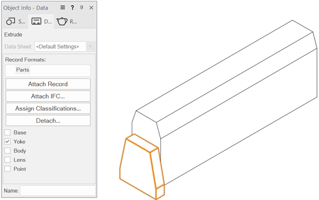

Click the Data tab on the Object Info palette. Click Attach Record to open the Resource Selector, and double-click the Parts record to attach it.
Select the appropriate part from the record fields: Yoke or Base.
If a part is used for tilting the multi-cell device (moving it along the X axis), that part must be defined as a Yoke. This includes the typical yoke hardware for hanging devices, but also the feet on floor-mounted devices. While the feet provide a base for the device, they must be defined as Yoke parts because the device uses them to tilt.
The foot on a floor-mounted cell symbol is defined as a Yoke part

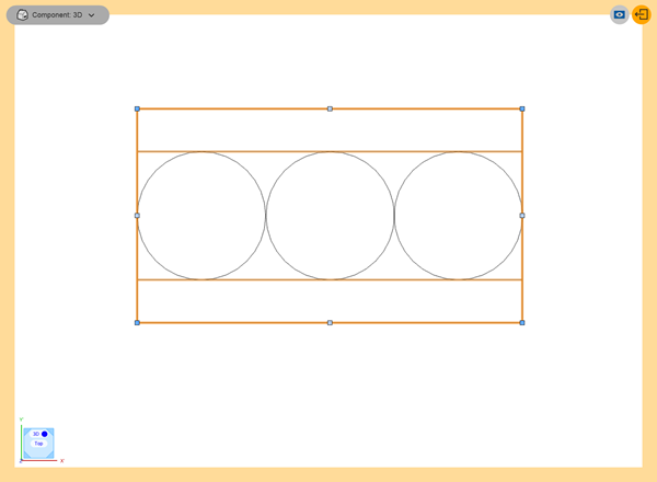

Automatically generate a simple line drawing that outlines the 3D components:
Select the 3D cell symbol, and select Edit 2D Components from the context menu.
The Object editing mode opens. The Component button displays with an edit options popover; set the Edit component to Top and set the Show Other view to 3D.
Select Generate from 3D Component from the edit options, and select the line rendering style for the 2D component.
The 2D geometry is created on top of the 3D geometry, so the two versions are automatically aligned
If needed, edit the 2D components as described in Creating 2D components for symbol definitions and plug-in objects. Set the line weights so the cell stands out when printed. The perimeter of the symbol should have a line weight of at least 0.25 mm. Interior details should use a lighter line weight, such as 0.13 mm or 0.18 mm.

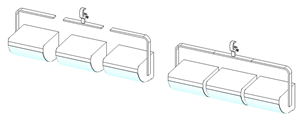

Multi-cell lighting devices rotate in 3D just like individual lighting devices. The yoke (made from portions of the nested cell symbols) is the means of rotation. A 3D locus point placed in the container symbol defines the axis of rotation.
Floor-mounted multi-cell symbol

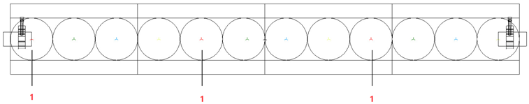

The order in which you place the cell symbols determines their index numbers. This is important for selecting and editing the cells in the drawing. The first symbol placed is cell #1, the second is cell #2, and so on. See Concept: Multi-cell lighting devices for more information about index numbers.

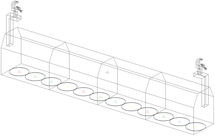

Multi-cell symbols can support multiple light emitters when rendering. Each emitter is associated with a 3D locus point. The 3D locus sets the precise location of the light source. When the Parts record is attached to the 3D locus (light emitter), the record's Light Emitter value determines which cell controls the emitter. All 3D loci with the same Light Emitter value will have the same light properties, as set by the controller cell. This is true even if the emitters are in different cells.
This four-cell strip light contains 12 light emitters. Each emitter has a color-coded 3D locus point. The red locus points are assigned a Light Emitter value of 1. These three emitters will be controlled by cell#1 to shine red light.
