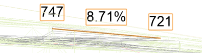

Longitudinal Profile
Define the elevation changes along along the path modifier, and set the profile appearance
Edit Profile
Enters editing mode for the selected profile, for editing aligned hardscapes or modifiers with profile lines (see Editing aligned hardscapes or modifiers with profile lines)
Start Elevation
End Elevation
Enter the starting and ending elevation of the modifier; alternatively, enter one of the elevations and enter a Slope value to automatically calculate the other elevation
Slope
Enter the slope value; alternatively, when the Start Elevation and End Elevation are entered, the slope displays
Realign Elevations
If changes occurred to an elevation, resets the affected vertex elevations
Fit to Surface
Conforms the longitudinal profile line to the surface of the site model
Profile Line Class
Profile Text Class
Select <Site Modifier Class> to place the profile in the same class as the modifier; select a class, or create a new class, to control profile line appearance and visibility
Elevation Marker
Select the elevation indicator type
Elevation Marker Factor
Specifies the scale factor of the elevation marker
Slopes Grade Def
Determines the how the Slope is calculated and displayed
Show profile line
Toggles the display of all profile line parameters (name, slope, elevation, and markers)
Show profile names
Toggles the display of the profile names
Show slopes
Toggles the display of all slope values
Arrow indicates downward
When Show slopes is selected, adds an arrow to indicate which side slopes down
Show vertex elevation
Toggles the display of all vertex elevations
Show profile line markers
Toggles the display of markers at the ends of the profile line
Profile Line Marker Styles
Opens the Set Marker Style dialog box, to select the profile marker type at each end of the profile line; markers can be the same (Match beginning) or different (Differentiate) at each end of the section line
