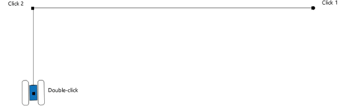

To insert a multicable:
Click the tool and mode.
Click to place the start of the cable, and draw the cable polyline, clicking at each vertex. Double-click to finish drawing the cable.
The first time you use the tool in a file, a properties dialog box opens. Set the default properties.
After placement, the cable path can be adjusted with the Reshape tool. The properties can be edited from the Object Info palette.
