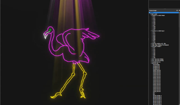

The Scene Graph palette displays an organized list of scene items, including layers, objects, and fixtures (lighting devices and lasers). Use the Scene Graph palette to select items in the scene, to select objects and fixtures for editing in the Properties palette, or to select conventional lighting devices for fine adjustments in the Software Console palette. The Scene Graph palette’s context menu provides options for organizing the scene contents, deleting items, replacing selected items, and troubleshooting display issues.

The ROOT list heading, or "ROOT layer," represents the contents of the entire scene; it contains a hierarchical list of layers, scene objects, and fixtures.
Merged scene files display as layers under the ROOT layer (see Merging files).
Click successive disclosure arrows to navigate the scene hierarchy. Press the Alt key (Windows) or the Option key (Mac) when clicking a disclosure arrow to expand or collapse all items in that layer.
Selected objects and fixtures are highlighted in the Scene window, and their parameters display in the Properties palette. When multiple items are selected, the displayed parameters depend on the first item selected; only that type of item displays parameters.
Selecting global scene parameters, objects, and fixtures
To select items, you may need to expand the layers in the Scene Graph palette:
From the Scene Graph palette, select ROOT to edit the global parameters for the entire scene (see Global parameters).
Expand the ROOT layer to access items within the scene. Use the Page Up/Page Down and arrow keys to scroll through the main ROOT layers. When a layer is selected, all items within the layer are also selected, so they can be moved and transformed as a group. These items are highlighted in the Scene window, and their parameters display in the Properties palette.
Exact parameter values display only if they are identical for all items in the layer. When a value differs, this is indicated by a double asterisk (**) after the parameter name, followed by a blank field or a value of 0.00.
Keep expanding the layers until you access an individual fixture or object, to select and edit only a single item. The selected fixture or object is highlighted in the Scene window, and its parameters display in the Properties palette. Lighting devices with accessories may also display parameters for gobo images and shutters in the Software Console palette. The displayed parameters depend on the lighting device type and accessories.
