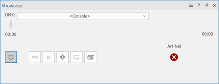

The Showcase palette can record the incoming DMX stream (a virtual or physical console that is specified in the Showcase preferences). The recorded DMX stream can play back lighting looks and sequences when no controller is connected.
To open the Showcase palette:
Select the command.
The Showcase palette opens. Because it is a palette, it can remain open when Showcase is active.
Parameter
Description
DMX
Displays and manages saved recordings for selection, or selects the <Console>.
Do one of the following:
Select <Console> to control Showcase from the live DMX data from the network.
Select a previous recording to play it in Showcase. Showcase automatically becomes active, and pauses on the first frame of the recording; the DMX file needs to correspond with the lighting devices in the current file for correct playback to occur.
Select Manage DMX Recordings to administer saved recordings; see Managing DMX recordings.
Timeline slider
Scrubs the timeline to the desired location; if you scrub while playing, release the scrubber to play the DMX file from that location. If you scrub while paused, the timeline remains paused after scrubbing.
Turn Showcase On/Turn Showcase Off
Toggles Showcase rendering mode; see Previsualization with Showcase. The button also serves as an indicator so you can tell whether Showcase is on (dark gray) or off (light gray).
Rewind
Returns the timeline slider to the start point of the DMX file
Play/Pause
Toggles between playing and pausing the DMX file. While playing, the previsualization follows the data in the recording. The time stamp indicator updates as the recording proceeds, and the slider moves to match. While paused, the DMX signal input continues, but playback pauses.
Record
Saves the incoming DMX data from the connected DMX signal. The recording time indicator shows the minutes and seconds recorded. Only the Stop or Record buttons are available; press either one to stop the recording and save the file. Provide a name for the recording.
Loop Playback
When the DMX file ends, loops the playback to the beginning to continuously play the file; press again to stop looping
Snapshot
Saves the live DMX state to a named, single-frame recording. A snapshot only has a single time position, so the slider, Rewind, Play, and Loop buttons are grayed. Provide a name for the recording.
Set Showcase Render Style
Select the render style to use for Showcase, and activate the selected style if Showcase is active, or select Unstyled. To manage the render style or render options, select one of the following options:
New Render Style from Unstyled creates a Showcase render style using the current render mode settings; select where to save the style and assign a name. The render style is added to the list of styles available in the file with all parameters set by instance, so they can be changed interactively while the changes display in Showcase. If Showcase is active when the style is created, the style is activated for the session. The style can be edited later from the Resource Manager.
Edit Render Style opens the Edit Render Style dialog box to interactively change the current render style settings while the changes display in Showcase.
Edit Render Options opens the Showcase Render Options dialog box to interactively change the current render options while the changes display in Showcase. For an unstyled render instance, all parameters can be changed; for a styled render instance, only parameters set by instance can be changed.
See Showcase render style for descriptions of the available render style parameters. Changes are saved with the file.
Alternatively, click the Current Render Mode Options icon on the View bar to open the current render mode/style dialog box and make interactive changes; see Shaded options for unstyled instances.
DMX, PSN, and NDI status indicators
When Showcase is active, indicates the status of the data streaming protocols in use, to help you troubleshoot when there is an issue. The DMX indicator displays the protocol in use (Art-Net, sACN, or MA-Net3).
 Good - Indicates a strong signal
 Fair - Indicates a medium signal
 Poor - Indicates a signal error or failure, or very poor or intermittent signal
Use the Showcase palette to record the previz from a connected console, or to view a saved DMX recording.
