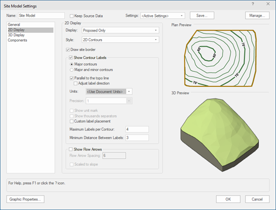

There are two ways to display a site model: existing and proposed. Existing represents the site before any modifications occur. The proposed site model is the existing site model, plus the geometric effects of site modifiers. We want to see the version of the site model where we plan to make various modifications — the proposed site model.
On the 2D Display and 3D Display panes of the site model settings, select the Proposed Only Display. Select a 2D Display Style of 2D Contours and a 3D Display Style of 3D Mesh.
On the 2D Display pane, display contour labels for major contours only, and make them parallel to the topo line, which is standard.
2D Display settings
Accept the remaining default site model settings, and click OK to create the site model.

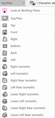

On the View bar, select Right Isometric from the Current View/Standard Views list, or just press 3 on your numeric keypad or use the Onscreen View Control cube to switch to that 3D view.

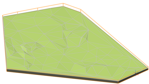

Use the Onscreen View Control cube or the Flyover tool to view the 3D model from various angles. If you hover the cursor over the site model, you can see the triangulation between the data points, which creates the site model surface.
Here is the proposed site model in a 3D view

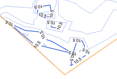

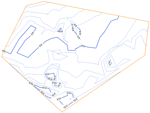

Sometimes, the source data requires adjustment after the site model has been created. If we focus our attention to some of the contours at 10.5 m, we recall from visiting the actual site that the these contours don't perfectly represent the elevations. This can occur when the elevation points from the survey are rather sparse.
We can go back to the source data and add (or remove) loci or 3D polygons at the proper elevation to make any needed corrections.

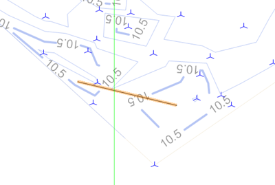

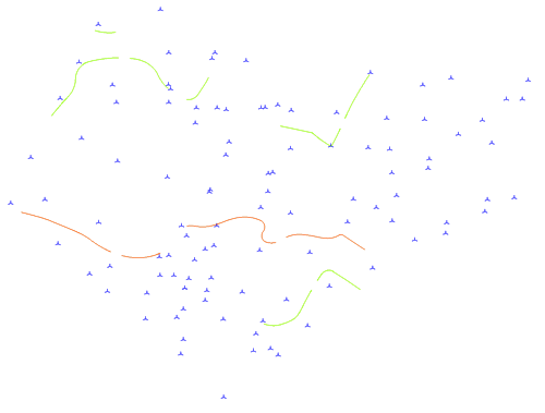

We can still see the Top/Plan view of the site model in the editing mode, which is very helpful. We want to stay in Top/Plan view, so we will stick with a 2D tool to make edits. Click the 2D Polygon tool  , click to draw a line connecting two of the 10.5 m areas at the bottom of the window, and double-click to finish.
Draw a polygon between the two areas at 10.5 m
We need to set an elevation for the selected line, so we have to convert it to a 3D polygon. Select Convert to 3D Polys. In the Object Info palette, enter an elevation of 10.5 m for the Z height. Exit the editing mode by clicking Exit Recreate from Source Data.

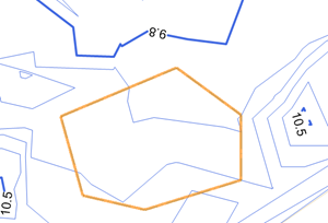

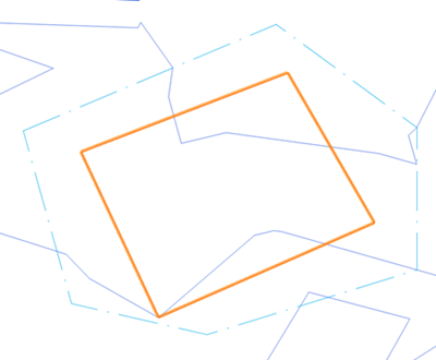

First, we need to establish the area of the site model where edits are permitted by drawing a grade limit. Beyond the grade limit, the site model remains undisturbed. The grade limit transitions from the proposed site model to the existing site model.
Click the Site Modifiers tool  and click Grade Limits mode . Draw the grade limit area between the 10.5 m contours.
Establishing the work area with grade limits

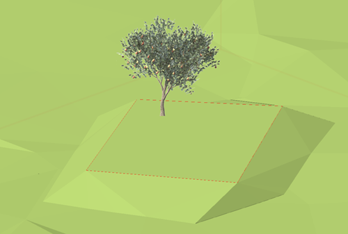

Let's add a slightly raised, flat area for the garden. If needed, zoom in on the area by scrolling with your mouse wheel. Click the Site Modifiers tool  and click Planar Pad mode . Draw a rectangular shape to create the planar pad within the grade limits.
Planar pad for the garden

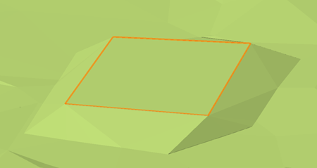

In the Object Info palette, set an Elevation for the pad modifier, of 11 m.

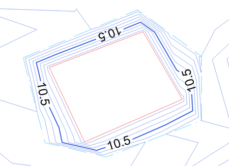

Update the site model by clicking Update Site Model from the Object Info palette. Now the proposed site model is modified by the pad, within the limits set by the grade limits area. Note how the grade limits define the gradually changing area of site model changes. Use the Onscreen View Control cube or the Flyover tool  to look at the pad in a 3D view.
Top/Plan and 3D view of the modified site model

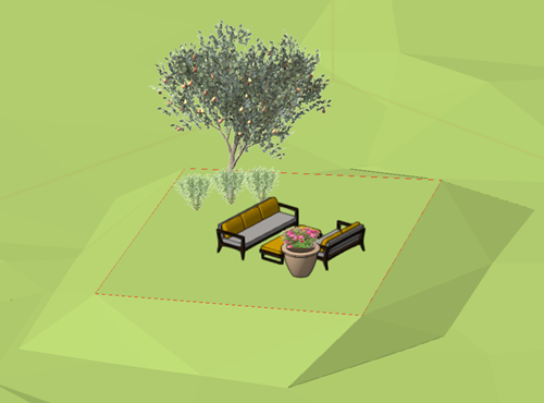

In Top/Plan view (select it from the Current View/Standard Views list on the View bar, or by pressing 0 on the numeric keypad), let's add a tree and some shrubs to the planar pad. Click the Plant tool . From the Tool bar, click the Plant Style list, and from the Basic Top Plan library, choose a tree such as Tree Linden Green 24 30pct from the Resource Selector.
 The name of the tree describes its 2D view color and its opacity. In the Resource Selector, you can search for "tree linden" as an example, to view only trees like this in the search results.
Place a tree on the pad.
We planted a tree in the garden
Now choose a shrub from the Plant Style Resource Selector. Place a few shrubs around the base of the tree.
Open the Resource Manager (Ctrl+R (Windows) or Cmd+R (Mac)) if it's not already open. In the Resource Manager, search for the term "layout." Select the "Site layout - Patio couches with planter" layout symbol, and place it in the garden area. Because we're in a 3D view, the symbol is placed on the surface of the site model.
We've added a comfortable place to sit

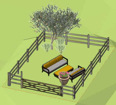

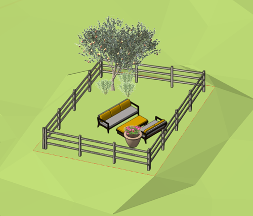

Switch back to Top/Plan view by selecting it from the Current View/Standard Views list on the View bar, or by pressing 0 on the numeric keypad. (You can place a fence in a 3D view as well, but it's easier in Top/Plan view). Add a fence around the perimeter of the garden area. Click the Fence tool ; from the Tool bar, click the Fence Style list, and select the Fence Wood Split Rail symbol (metric) from the Resource Selector.
Click to start drawing the fence, and click at each corner of the pad to place the fence. The fence is automatically placed on the surface of the site model.
Press 1 on the numeric keypad (or use the Current View/Standard Views list) to obtain Left Isometric view.

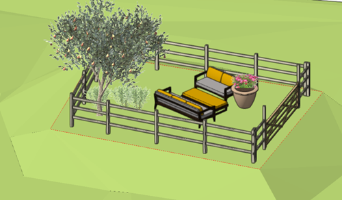

A fence will keep deer away from the garden
We need a gate to get in and out of this relaxing garden spot. Select the fence, and click the Reshape tool . Click Gate Mode  and Add Gate mode , and select a gate from the Gate Configuration Resource Selector. A gate to match the fence is already suggested. Click on one of the fence's panels to place a gate in the fence.
Looks like a nice place to relax!
