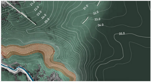

Create the site model
In Top/Plan view, with the elevation data selected, select Site model from Source Data. Set up the site model as you prefer (you can always change the settings later) and click OK. This is the site before any modeling is done: the existing site model.
In a standard workflow, don't move the site model along the x,y, or z axis. In the event you are working on a high elevation site (thousands of meters above sea level), there are adjustments to be made, but this is beyond the scope of this workflow.
Go through the site model and ensure that it represents the actual site, and that it doesn't include heights of existing objects. If you find any incorrect data, select Recreate from Source Data, and adjust the data. When you're satisfied, it's time to create some site model snapshots.
Set the site model display to the most useful settings and create a snapshot. For example, a colored slope view helps you monitor slope changes of the site, or create a view that shows water flow arrows. Place snapshots on a separate layer or in a separate class from the site model, as this allows you to keep it hidden when not needed.
