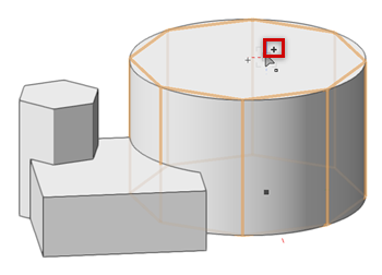

Set snapping and SmartCursor cues
Snapping settings control how the SmartCursor snaps onto key points so you can draw and edit with precision in Top/Plan and 3D views. When used with drawing tools, the SmartCursor provides visual cues like snap indicators, hints, extension lines, and text, and then snaps the cursor exactly where it needs to go. You can turn the SmartCursor on and off with the Y key, or by clicking each button or Suspend Snapping in the Snapping set, which is pinned to the View bar by default.
Snapping types can be used individually, combined, or in conjunction with the Data bar input. For most drawing, we recommend turning on Snap to Object, Snap to Angle, and Snap to Intersection in the Snapping set, and Show SmartCursor cues in the General Snapping Settings popover.

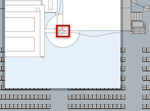

Zoom with the snap loupe
When it is difficult to find the desired snap point, you can use the snap loupe, which temporarily zooms in on the drawing to obtain the snap. To use the snap loupe, move the cursor to the area where you want the snap to display and press the Z key. If the snap loupe isn’t zoomed in enough to find a snap, press Z again. The snap loupe window closes automatically after the desired operation is performed. Alternatively, press the Esc key to exit the snap loupe without clicking, or click outside of the loupe to close it.

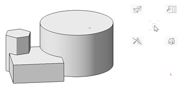

Smart Options Display
When enabled in quick preferences, Smart Options Display improves focus and efficiency by giving you quick, context-sensitive access to your favorite tools, tool sets, tool modes, standard views, and snapping options, right next to your cursor in the drawing area. You can customize both the display settings and how to trigger Smart Options Display to appear in the Smart Options Display pane in Vectorworks preferences. After triggering the Smart Options Display, simply move the cursor to the contextual hint for the option needed, and click the item to select it.

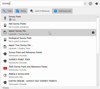

Quick search
With Quick Search, you can find commands, tools, and quick preferences right from the drawing area. You can also connect to related online resources, like help topics, Vectorworks University lessons, and YouTube videos. Use Quick Search by selecting the command in the Tools menu, using the F keyboard shortcut, or by clicking the Quick Search icon  on the Title bar (Mac) or Menu bar (Windows), and then entering text into the search bar. The Quick Search window opens, where you can enter text into the search box, access Vectorworks preferences to customize your search, access help resources, and so on.
