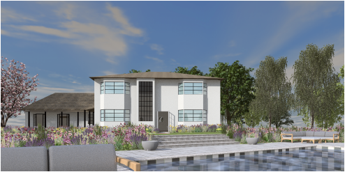

Present the plan
You likely will need to generate attractive graphics to present to a client or potential project donors at any time during the design process.
To create a 3D rendering of the model:
Use the Landscape Area tool with a mix of plant styles that provide the desired appearance to create the effect of full planting beds.
To present impressive-looking trees, use good-quality 3D image props for the plant style 3D graphics.
Use the Foliage tool to create any needed plant features such as greenery trained over a shaped form. Foliage features are appropriate for presentation, but do not appear in plant schedules. Foliage objects are memory intensive, so use them sparingly and for a specific purpose.
Add backgrounds to the model for context and apply textures to other 3D objects for a realistic or stylized appearance.
Use the Renderworks Camera tool to place cameras at desired locations and set the look-to points. Double-click a camera to activate its view. This allows you to quickly detect any sight-line issues. Click Fine Tune Camera View to adjust the camera's height, pan, focal length, and so on.
When testing camera angles and establishing the views to present, use Shaded rendering mode, which responds to changes much more quickly than a Renderworks mode.
Use a Renderworks mode to render the viewports to control the speed and quality of the final rendering.
Create saved views for easy display right from the Vectorworks file, or to return to the same view after editing the file.
Create viewports from camera views, saved views, or other methods.
Create animations or 3D model views to give the audience the sensation of walking through the space.
Use the Vectorworks Cloud to process files and to share files with clients or collaborators (some functions available only with a subscription or as a benefit of Vectorworks Service Select).
