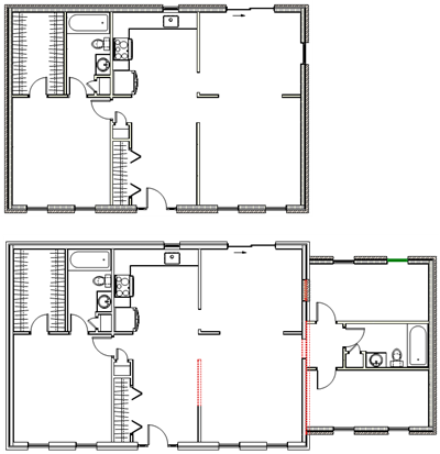

Data visualization displays the changes between the first phase and the second phase
In a design layer, use document preferences to set a low detail level for component-based objects and/or plug-in objects and symbols based on their status in the active phase. You can also set phasing-related low detail level preferences for objects on each sheet layer viewport or viewport style. These settings override the default document preference for detail levels on design layers, and the detail level setting for each sheet layer viewport.
